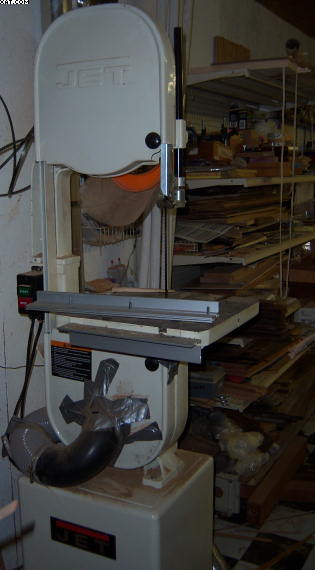

I have the Jet 14" (with riser block), complete with carter guides and cobra tension spring. The only problems I have had was the dust collection port not being in the right place. I modified mine by cutting a 4" hole in the lower guard and connecting the 4" dust hose there. Solved the problem (when I can remember to turn the vac system on). The other problem I have is that blades break often. I havent figured out what is causing this to happen, but I wish I knew so I could fix it.
It does cut clean when resawing and leaves very little blade chatter in the cuts.

Do the blades break on the weld or elsewhere? If it's the weld and if you're getting them made locally, your saw shop isn't doing a decent job. Few local shops weld and anneal well. I've been through this, and I now get my blades from Timberwolf, and they don't break unless we push them way beyond when they should be changed.
As for turning it on, check out the "EcoGate" blast gate system or put micro switches on your blast gates to a relay controlled magnetic starter on your dust collector.   Open the blast gate, and the collector will automatically come on. You'll need to run a pair of wires from the switch on each blast gate back to a central box where all are connected to a pair of bus bars, and the buss bars to relay in a mag starter. Pull out any blast gate, the switch closes the circuit tripping the relay in the mag starter. The relay input works at low voltage, so it' quite safe.   Now I just have to do that when I redo my main dust collector.

Rick, the blades dont break on the welds. I have bought just about every brand of blade you can immagine and they all break from the back of the blade after about 6 total hours of use. The blades are usually still plenty sharp when they break.
I generally buy either 1/2" or 3/4" blades that are 3TPI because I generally use it for resawing. I buy the blades with a rake specifically designed for resawing too. I dunno what the problem is...it saws good when it is sawing....just goes through alot of blades.

Check out the Timberwolf ASS resaw blades.   They're made on a .025" band with .010" set either way, so they only take out about a .046" kerf.   Being made at .025", they're more flexible, too, and so they may hold up on 14" wheels longer than a thicker blade.   They're double induction hardened...the teeth and the back of the blade.   I run these on my Baker resaw, and I try to set them up so they don't bear against the back-of-blade bearing much while cutting. I haven't run these blades on a smaller saw, but on the big Baker, they're great.   The other Timberwolf blades...we normally run a 6 tooth 1/4" blade on the smaller saws...work just great, too.
